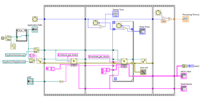

We have built an interface to this python code inside of LabVIEW that allows us to do what we want. You could do the same thing. It would also make it so the version of Office does not matter any more:

Can you roll your own?
I'm in the process of pulling out the report generation tool kit from all my code for many of the reasons you talk about.  It's temperamental, and SLOW as all get out.
The attached is very much a draft attempt and no where near finished.  use for inspiration (even if what not to do).
I'm very much interested in what you come up with.
