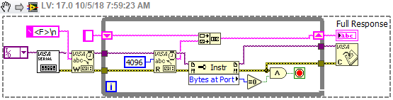

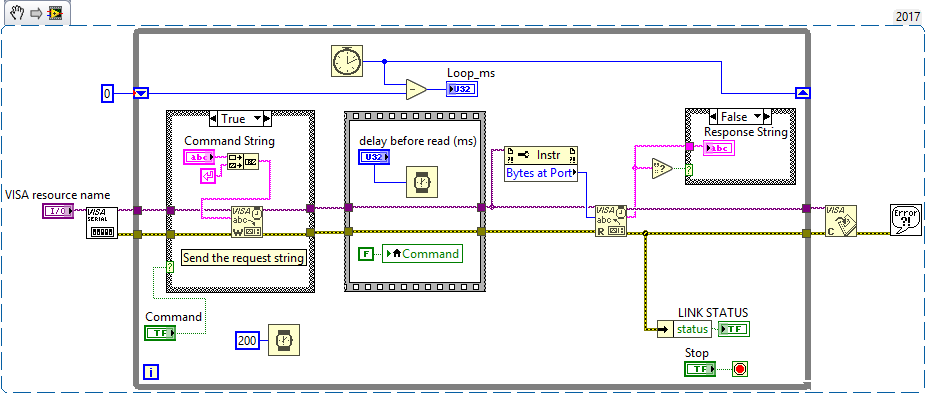

Would like to hear from experts on this .. I have enclosed a typical diagram to explain the process :SimpleReadWrite Serial_LV17.png

This may be one of the rare instances where using Bytes at Port might make some sense.
  My experience is that 99% of the time you shouldn't use it.  The complication of having multiple linefeeds in a single response message is what complicates things in your scenario and will require you to do multiple reads.
Let me ask the question, does the CSV file ALWAYS end with a linefeed character?  If so, what I'm about to propose should work.
1.  Write your command.
2.  In a while loop do a VISA read with a very large number of bytes, more bytes than the longest single line of a CSV file you ever expect to read.
3.  Append your message to a string you keep in a shift register.
4.  Read the number of bytes at port.  If equal to zero, then end the while loop.  You should also AND this with the error wire from the VISA Read.
I'm assuming here that when you do a VISA read and it stops at a line feed in the CSV file data, that there will already be at least one byte sitting in the buffer from the next line.  That is what keeps the While Loop going.

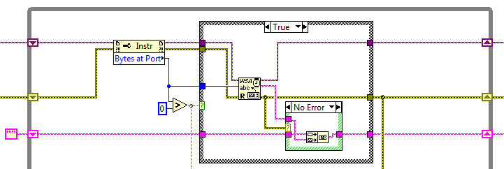

Example_VI_BD

Thanks ... yes i also agree that Bytes at Port often leads to issues when a variety of incoming byte stream scenarios are to be handled. I saw your method of using both which is differnt line of thinking. In my case I send a OK from the MCU when the last record is sent and hence I compare the incoimng stream and terminate. Works most of the time !! And few odd times the stream gets stuck
Anyway since yesterday I brought in another refinment to change the while loop timing dynamically- 200mS when receiving four byte response and 5 ms timing when receving a large stream of bytes. Trials are encouraging ... let me see if it helps to resolve the issue completely.
