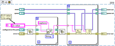

Here is mine.
Sam Taggart
CLA, CPI, CTD, LabVIEW Champion
DQMH Trusted Advisor
Read about my thoughts on Software Development at sasworkshops.com/blog
GCentral
Message 7 of 147
(7,954 Views)
