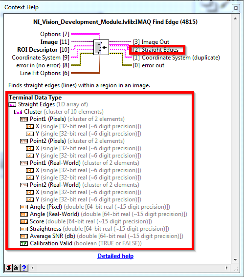

The output of the IMAQ Find Edge was an array, so thank you for clarifying the difference.  I am attaching screen shots and the program file in an attempt to clarify what I am attempting to accomplish.  I apologize as I know this aren't the technical terms, but I need the Straight Edge coordinates as individual integers so I can store the value.  The value is the Y-pixel coordinate of the edge shown in the screen shot.
(3,903 Views)
I assume you are referring to the outputs of the IMAQ Find Edge VI? Context Help (Ctrl-H on Windows) is your friend. Open this and then hover over the terminal of interest to see detail on what it is. For example I hovered over the "Straight Edges" terminal and it told me that it is an array of a custom data type (which we call a cluster, also known as a struct in other C-oriented circles). If I wanted access parts of this entity I would need to index the array first to get to each cluster item and then unbundle the cluster (by name would be helpful) to get to the appropriate element of the cluster. Using this thought process have a go at how you would approach your problem and give us a shout back with your progress.
