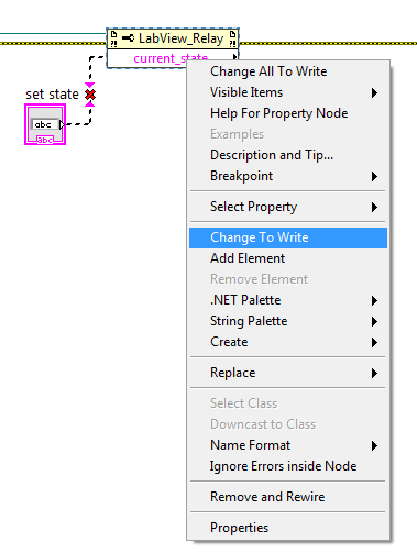

Hi. When using a "property node" to access an object's property, the property field is created in "read mode" by default. With the LabVIEW UI, a simple right click / "change to write"  operation allows to change it in "write mode" :

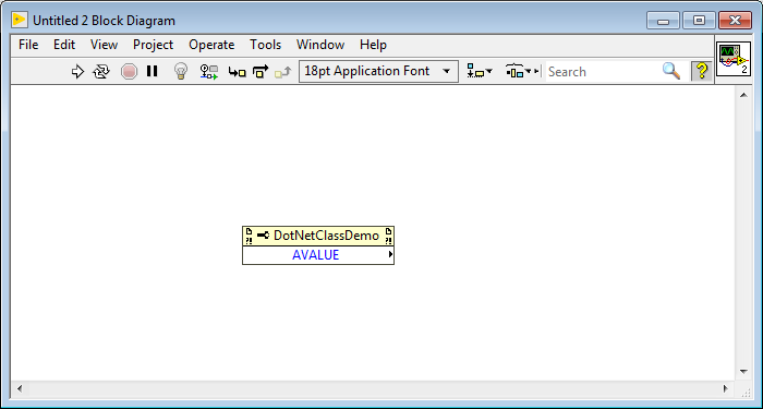

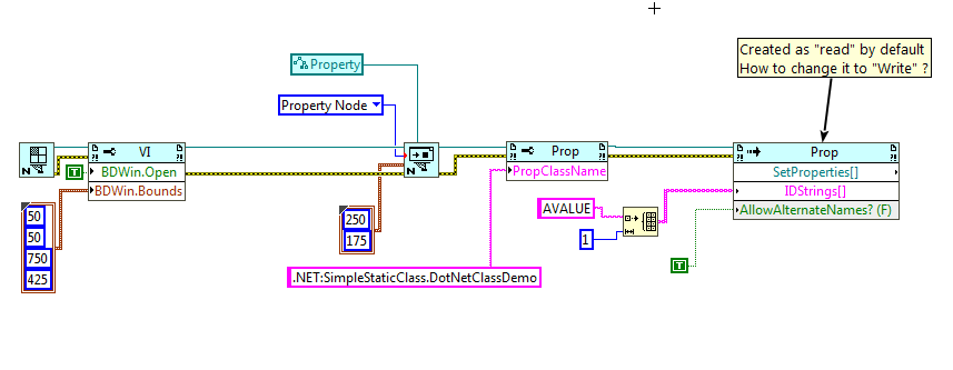

But I couldn't find a way to do this with VI Scripting. Here is a practical example, with a vi script (attached) creating a property node accessing a property named AVALUE from a .NET DLL (attached too):
And here is the result:change-to-write-3.pngchange-to-write-3.png
How am I supposed to change AVALUE property value into "write"  through VI scripting?

The array output of the Set Properties method gives you references to the individual properties, which you can then configure:
(3,631 Views)
Hi Darren. Thank you  (again) Smiley Happy
