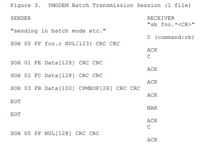

I have found the protocol here:
http://www.blunk-electronic.de/train-z/pdf/xymodem.pdf
page 16:
