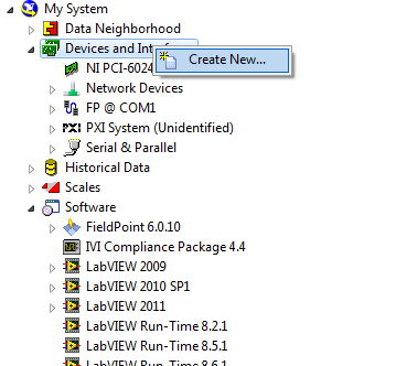

1) Add your FieldPoint Serial Device in MAX by right-clicking on "Devices and Interfaces" and selecting Create New...

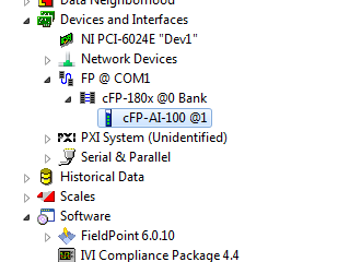

2) Select FieldPoint Serial and configure it appropriately. Now you should be able to see your FieldPoint under Devices and Interfaces. It should autodetect the modules you have; If not, right click on your Bank and choose "Create New Device" to add your DO module manually.

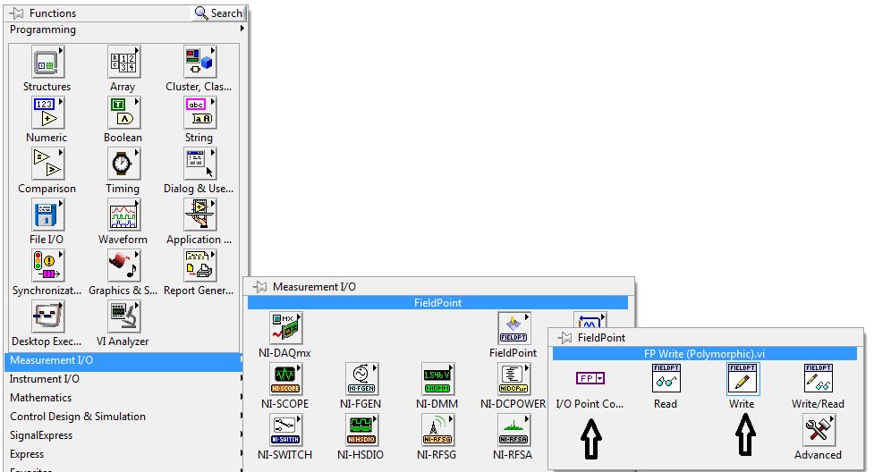

3) In LabVIEW, navigate to your FieldPoint palette by opening your Functions palette>Measurement I/O>FieldPoint. There you should see FP Write and the FP I/O Point. These should be the only blocks you need to set you DO to true.
4) Wire them up as shown below. Click on the purple arrow and choose Browse.

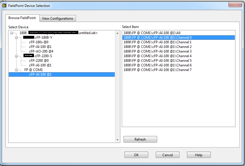

5) If you've configured it correctly in MAX, then you should see your FP@COM. Expand to select your module and channel that you want to change the value of.
6) Now its just a matter of writing true or false to the input of the FieldPoint Write in order to change the output. (You do need an extra external power supply to produce a Digital Out). Among other options, you could put the FieldPoint Write in a case structure in order to control when you want it to write true and when false. Be aware that this will be software times and that update rates won't be extremely high.

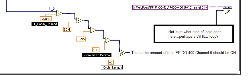

However, I believe that I over-estimated my understanding of steps 1 and 3.  For reference, below is the portion of my block diagram as it appears now:
As you can see, given T_5, T_Cabin_Desired, and Cycle_Length, the arithmetic on the left calculcates the amount of time that I'll require FP-DO-400 channel 0 to be turned on.  For example, if T_5 is 26 and the constants from the diagram are used, then the Channel_On time would be 14.42 seconds (Channel_Off time would be 40-14.42=25.58 seconds).
So....what I need is some way to output 'True' for 14 seconds, and then 'False' for 26 seconds...then repeat.  I was thinking that I could store the output of the arithmetic on the left as a variable (Channel_On_Time) and then use a loop structure similar to the pseudo-code below:

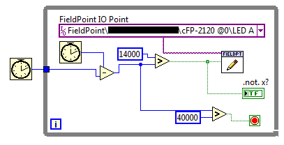

Hi Tom,
There are, of course, a number of ways you could implement this functionality and only you can be the judge of what it best.

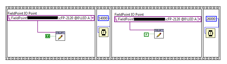

You could use a while loop, calculate the time elapsed (by subtracting out the current tick count from the starting tick count), and use the current time to determine whether or not to write true or false to the DO. Here's an example of that idea:
The only problem with that is you're constant writing values to the FieldPoint that you really only need to write once. So you could also just use wait VIs to wait for 14 s after writing true to it and then write false:
This list of options continues. Good luck!
