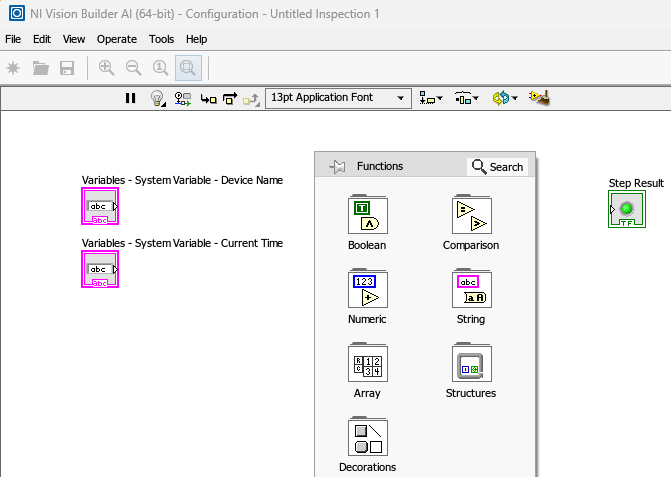

The only working solution which I have seen is GCalculator from VBAI:
This is a very simplified "LabVIEW" with just few basic functions embedded into VBAI UI as child window. LabVIEW development environment is not requred to be installed as far as I know. Internal result of this step is VI with defined Inputs/Outputs, which later called dynamically.

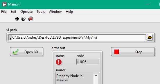

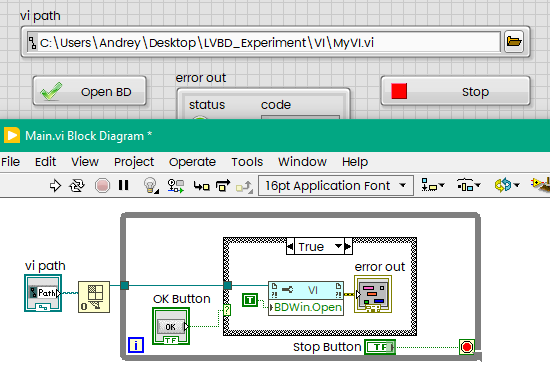

For example, if I will try to open Block Diagram of the VI programmatically like this:
then in Run-Time when compiled to executable obviously we will get error 1026:

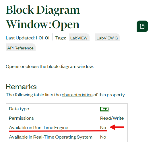

because this method is not officially available in Run-Time:

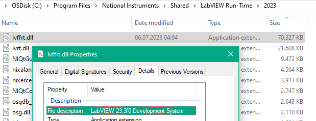

Well, now if I will install latest VBAI, then "Full" Run-Time called lvffrt.dll will be installed into "C:\Program Files\National Instruments\Shared\LabVIEW Run-Time\2023" Folder, which is in the fact LabVIEW 2023 dev environment in DLL form:

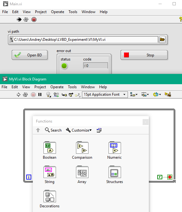

Now the "BD Window Open" method will be successfully called also from executable and editable Block Diagram can be opened in builded application and basic functions are available:
