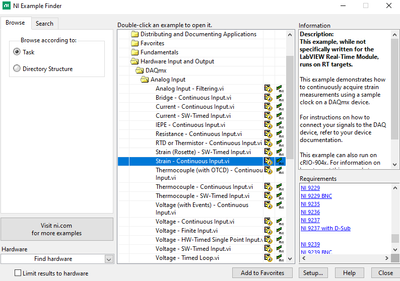

Start by looking through the example code.  It should be under the "Help" menu, under the "Find Examples" selection.
This one, for example, links to "C:\Program Files (x86)\National Instruments\LabVIEW 2021\examples\DAQmx\Analog Input\Strain - Continuous Input.vi" on disk and as long as you can see your card modules in NI-MAX you should be able to start using DAQmx code to get data from it using the example VI.
