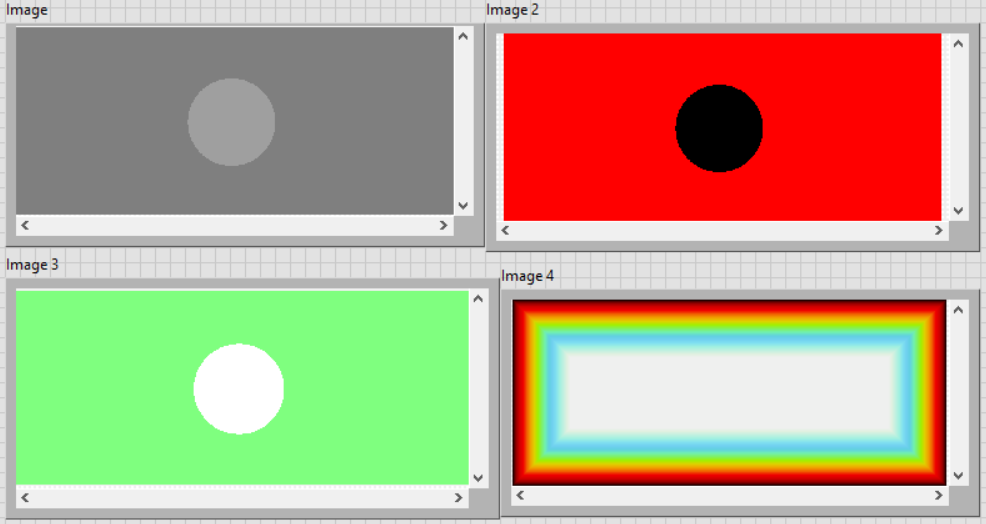

I tried your code using the PNG that you attached as the data file.  No errors, and it returned this:
I'm running LabVIEW 2016 (32-bit) and NI Vision on a Windows 10 (64-bit) laptop.
