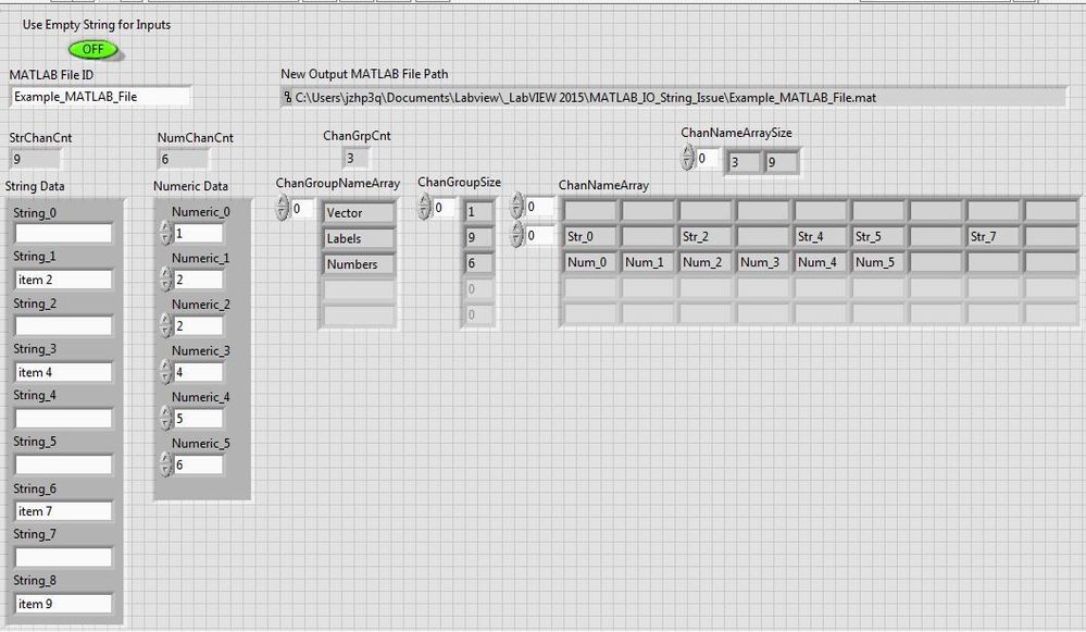

I’ve encountered an issue with the MATLAB Data Plugin. I hoping that someone can describe a work-around or confirm that I am out of luck.  The issue that I am having involves writing string data channels to a MATLAB (.mat) file from LabVIEW. I have to output some data from an existing LabVIEW application in MATLAB format for transfer to an external customer.  It appears as if any attempt to write a string channel containing a non-empty string value results in a failure to output any channel properties (Name,Description,  signal, etc.).  If an empty string value is written then the channel properties are present in the output.
I’ve created a simple VI to demonstrate the issue (attached). Toggle the “Use Empty String for Inputs” boolean control ON to see the desired (correct) results in the “ChanNameArray” indicator.  Alternatively, you may clear or modify ant input prior to executing the VI.
The correct structure of the output file should contain three channel groups (“Vector”, “Labels” and “Numbers”). The “Vector”  group should contain one channel named “FileId”.  The “Labels” group should contain 9 channels named “Str_0” …”Str_8”.  The “Numbers” group should contain 6 channels named “Num_0” through “Num_5”.
Fig. 1 Correct (desired) output obtained with empty string channel data
The channel name for non-empty string channels will be missing the channel name within the ”ChanNameArray” indicator as seen below.
Fig. 2 Incorrect output obtained with non-empty string channel data on some string channels

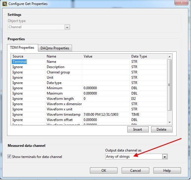

Thanks for the suggestion.  After further investigation I discovered that there is no error in writing string channels.  There was an error in my configuring the Get Properties Express VI to read the channel names.  Apparently, when querying a string channel this VI must be configured to output an array of strings even if the output signal is not being connected.  This was my error because I was only verifying the channel Name and not the actual signal contents.  I've attached a revised version of my original VI that works for my purposes.
This must be set to Array of Strings for string channelThis must be set to Array of Strings for string channel
