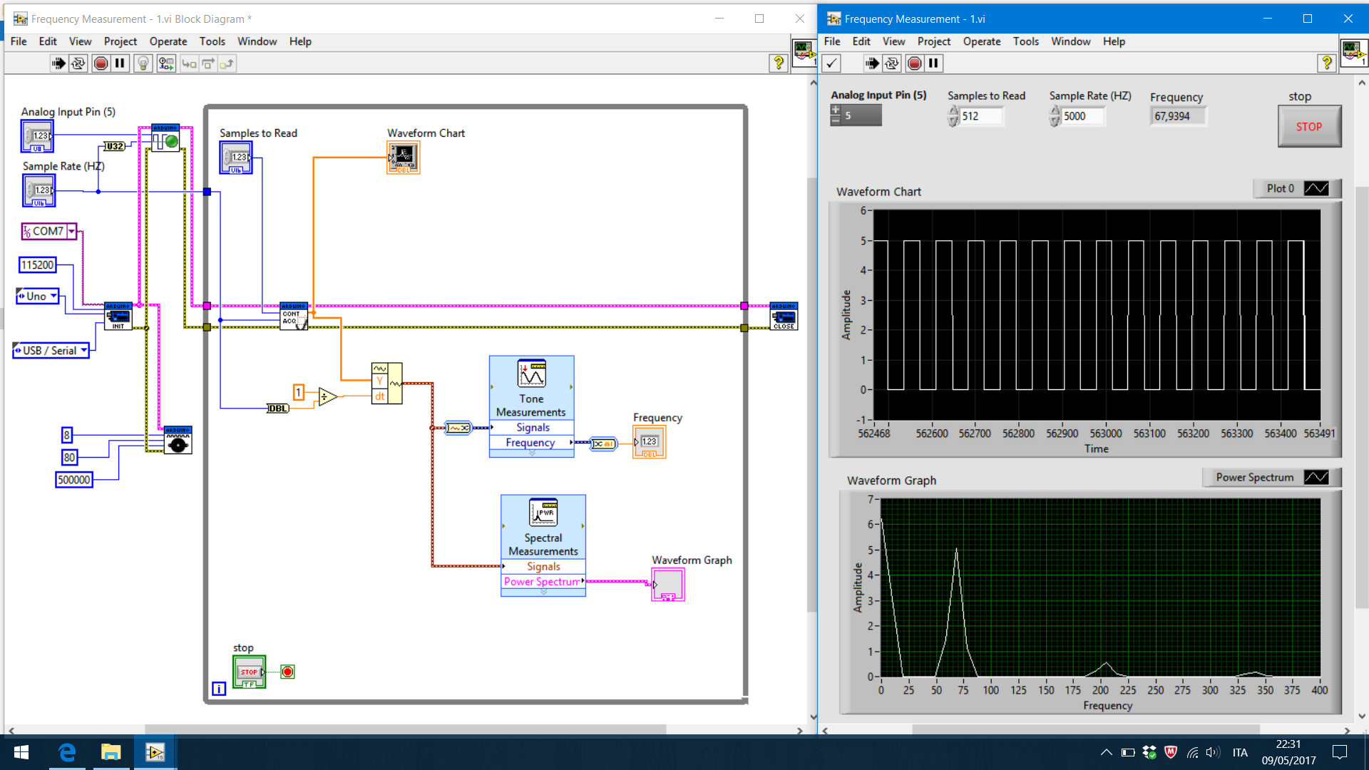

I'm trying to realize a simple frequency measurement with Arduino Uno.
The connection between Arduino Uno and LabVIEW is ok, but the value of the measured frequency with LabVIEW is not correct.
You can see from the image that I'm generating a tone from the Arduino digital pin #8 with a frequency of 80Hz, but both the Tone Measurements and Spectral Measurements block gives me inconsistent results compared with  the input signal.
I tried to use different LabVIEW blocks but I had always the results.
I also tried different sampling frequencies and different number of samples.
Do someone know why? What can I do?
Thanks.

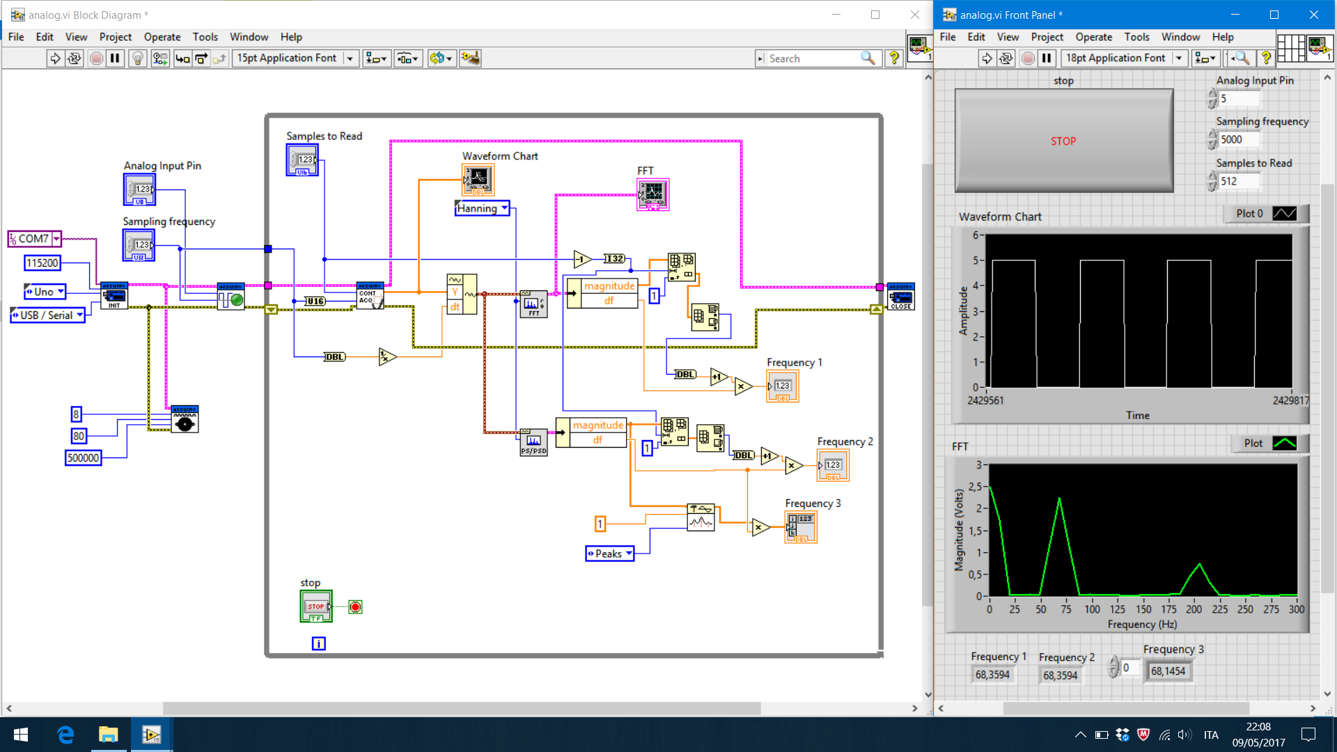

Thank you for the reply!
I'm using LIFA_BASE. Sure I can attach the VIs, here they are...
In my opinion, the problem is in the data coming from Arduino or there is a problem in reading data with the Continuous Analog Read block.

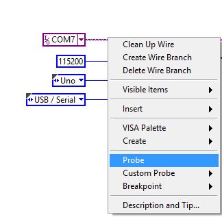

I would suggest that you first debug your code with the lLabVIEW debugging tools
Also insertion of Probe will show you the value (of the wire, cluster…) in real time.
select the wire >> Right Click>> Probe
Like that you can see if the values you wanted to generate from your Board come as expected.

Yes, I've already used the probes and the data that I see are not as I expect.
Since I'm acquiring a signal at 80Hz with a 5 kHz sampling rate, I expect 31 high and 31 low pulse samples, but what I see is 29/30 high and low pulse samples.
There is definitely a problem in the data acquisition, but I don't know whether from Arduino side or from the LabVIEW side.
