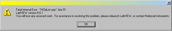

LabVIEW 8.6.1. Application is running on various dual-core Intel systems.  It makes great use of multiple threads, LabVIEW objects, queues, notifiers, etc. The problem is reproducible about 20% of the time by heavily loading the application, but it takes a while to build up the load.  This happens in both source and built EXEs.  The initial problem is announced by a popup saying "LabVIEW Internal Error: "hObjList.cpp", line 91<next line>LabVIEW 8.6.1"
When this is clicked, it is usually, but not always, followed by a  popup (I suppose from the C++ rts) complaining about a pure virtual function call.This popup spontaneously vanishes so quickly that it is difficult to get a screen shot of it.
