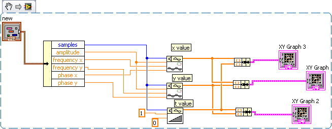

Here is a version with some changes:
Update display only after a change
a version without express vis is shown
Your solution will need some kind of ring buffer to store the x,y,t values , see examples for ringbuffer.
A nice math and programming task  is to change the phase continiously in the lissajou figure while changing the phase. Have fun 🙂
using the sine wave.vi and ramp pattern vi from AAL base.....
