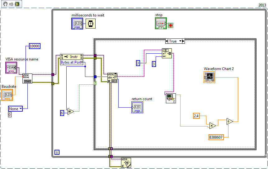

but when I run LabVIEW, it work few second and Communication suddenly abrupt and LabVIEW has hang. u can see that in below image that I capture from my decktop. Why LabVIEW hang ?
image is front panel of my VI.
whenever it hang, I must restart LabVIEW and test again. in meanwhile I must said that hang is randomly occur.

baudrate is ok. I changed it to 115200 but LabVIEW hang again !!
This is image from my Control panel.

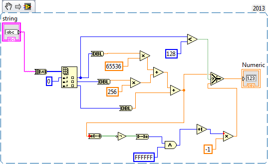

Sub VI in above image get a 24 bit 2's Complement hex string and it's output is DBL number which can be positive or negative. Sub VI is shown below :
Sub VI work correct and in my opinion problem is not from that.

I don't see a Write.
Message 5 of 28
(6,188 Views)
Is your communication really using a Termination Character? You did not deactivate it on the serial configuration VI.

The hang isn't "random".  It's telling you that you don't understand how to communicate with the equipment.  I see you are using bytes at port AND using a termination character (on by default in the serial config).  Use one or the other, but not both.

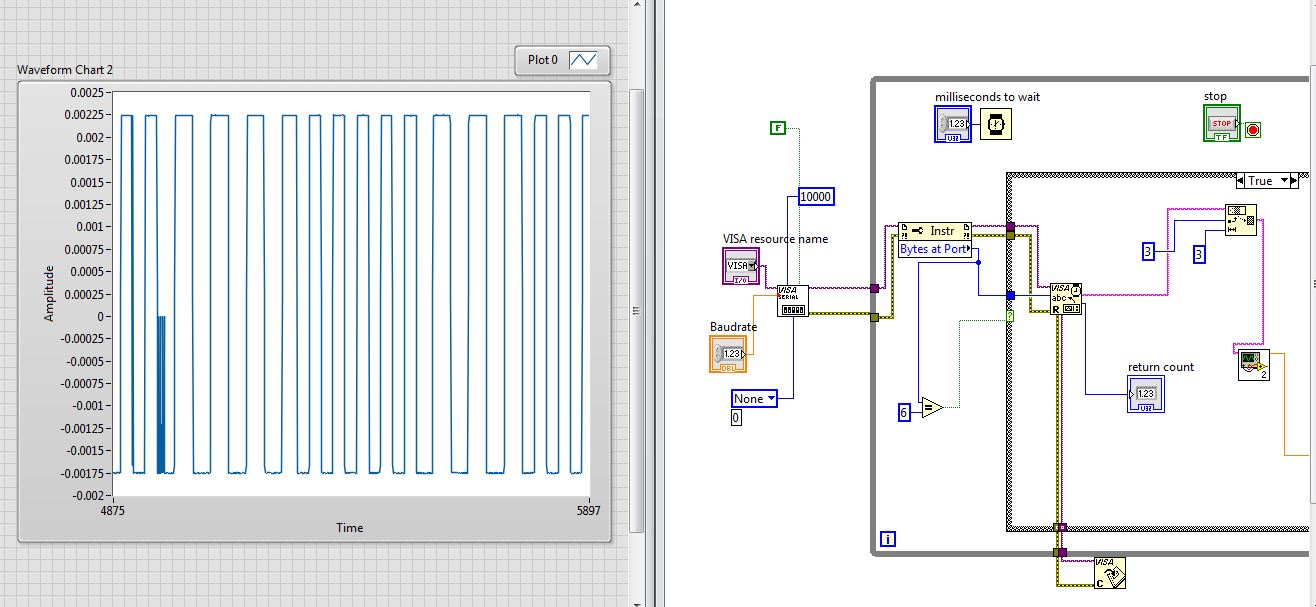

as you said I deactivate termination character and run my VI again.
it's run correctly longer than previous mode but yet has same problem and hang again !!
it's new image from my VI :
as you see above, problem which was hang in receive still is !! Smiley Frustrated

Please connect an error out indicator. Also, what is special about 6 bytes? You have absolutely no synchronization so it would seem that the bytes are just random. It would be better to append a termination character with the micro code and enable it on LabVIEW.
Message 9 of 28
(6,135 Views)
How I can connect  an error out indicator to my VI ?
6 is not my hero number Smiley Tongue   ,  in micro I send 6 byte every time to PC and I set this point in byte as port .
your offer is I append a byte to my Protocol and send 7 byte in every Communication with a termination character like 'A' in end of my Protocol ?
