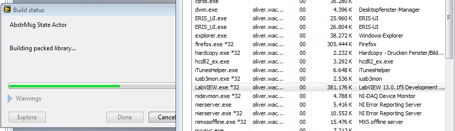

I have migrated most of my object libraries to PPLs (suffering the common pitfalls). But yesterday I encountered a (what I think) Biuld process specific issue:
after updating / changing som dependencies I tried to re-build, but LabVIEW locks up in the build process: the dialog says "Building packed library"
and LabVIEW can only be stopped using the Task Manager.
What I see in the target directory is, that all the dependencies are generated corretly (PPLs themselves) as well as a ZIP File with the name of the target PPL.Using 2013SP1f5

To get a bit more specific:
The build does not really fail, it causes LV to hang.
In fact, it keeps like that forever. Cancel Button itself can be pressed, but there is no real Cancelling the process within five  minutes or so... so in fact, LabVIEW has to be shut down using the Task Manager. This will also result in an automatic error report.

BTW, the ressource allocation is pretty relaxed.... memory consumption jitters a tiny bit, but LV is in fact idling

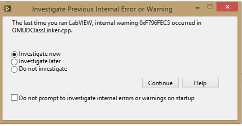

On this computer, the NI Error Report did not always occur; if it didn't LV came up with the following eror message:
Might be related to f2, but maybe it might be a hint.

(5,479 Views)
Hey,
just to give you some feedback. After fixing a common error with my german installation of LV 2013SP1 I'm also getting your warning message between shutdowns. Other than that the build process works whether I enable or disable Debugging.
