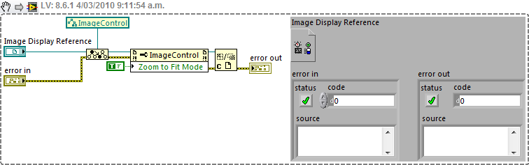

Yes I wondered if IMAQ might be the problem!  I have no problems opening ZoomFit - here's the block diagram:
I wonder if the problem is with typecasting the reference - I've noticed strange things with this before. The type ends up as "Plugin DDO Control Refnum", but I can't seem to create (or pass) a strict reference of this type.

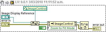

Strange - I have no problems loading this in 8.6 or 2009.  I've just recreated it in LabVIEW 8.6.1.  Here it is, also attached.  The only things on the front panel are a generic Control Reference and Error terminals.
If I delete this from the main program, I still don't get it to compile.
