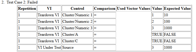

I am trying out the Unit Test Framework now included with LV2012 with some LVOOP code but seem to be running into some problems.
I have constructed a unit test for a basic class in the attached project which is the source class (There is another class in the project as this is an example of a retrieve method but it is not used in the unit test). My problem is that I get results that fail for one of my tests when I think they should work.
Basically the unit test is set up as the following
Case 1) Test the VI without the setup VI and ensure default values work
Case 2) Test VI by setting specific values in the setup VI and test them at the Teardown VI and also check the single output from "Source Method.vi"
Case 3) Test the VI with the setup VI using it's default values and confirm them via the Teardown VI
When run Case 2 fails and reports that the Teardown VI is returning default values not those fed in from the Setup VI. I can't see why.
As per
Any suggestions?
All the best
David

Hi dpnsw,
I've downloaded your files and am running into the same issues. It aopears to be always reading the default values out of the Source Read Cluster, but since cases 1 and 3 both expect those values, those two cases pass. Whenever you run Case 2, since the expected values have been set to be the input values of the Source Write Cluster, it compares them with the default Source Read Cluster values, and fails. If you run the VI, since it passes the Source Write Cluster values to the Souce Read Cluster Values, all three cases fail in subsequent tests. That being said, I have not figured out exactly what needs to be done to pass all three tests. I'll continue to look into it, and will let you know if I find anything. Let me know if you make any progress.

Hi dpnsw,
I've done some more research into the unit test and LVOOP question you had and I believe I have found a solution. It appears that both the OOP code you wrote and the unit tester were working properly. However, there was one small issue with the unit test configuration. The inputs and ouputs weren't designated in the setup and teardown section of the unit test properties window. Tests 1 and 3 still executed properly and passed because they were simply outputing default values. However, Test 2 was failing because it was asking the VI to pass values through without telling it how. Basically, it was "unwired". I have attached a screen shot of what Setup/teardown configuration allowed the unit test to pass all three cases. This configuration tells the VI how to pass the values properly.
