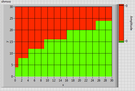

Does anyone have an example of making a shmoo plot like the one shown here? https://www.ni.com/en/support/documentation/supplemental/11/designing-semiconductor-ate-with-the-ni-...

Look at number 5 custom debug tools.

Looks like a simple intensity graph.

Except for the fractional values on the axis scales.  The intensity graph uses the indexes in the array as the axis values.  Of course the scales could have been customized.

Another idea: duplicate the plot on the waveform graph, and play with Fill Base Line option of both plots.

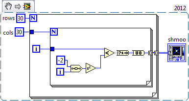

I have the intensity graph working almost right. I'm pretty sure it will fit my needs. I had never needed to use this kind of graph before so it wasn't on my radar. Thanks Darin.K
PiDi and you upload your vi in LabVIEW 2010?
