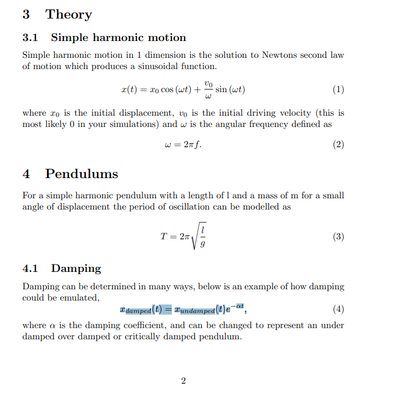

Yes sure please try this file im attaching
Also these were the formulas i had to work with

Hi JT,
are you sure your formulas are correctly translated to LabVIEW?
Did you try to debug your VI using probes/highlighting?
Cleaning up the block diagram also helps to understand the code:
Why did you use the log2(x) function when your formula says to use the exp(x) function?

Im very new at this stuff but thank you so much for your help. When it comes to damping is my method correct ?

Hi JT,
when translating formulas into LabVIEW code it always help for clarity/documentation to use indicators with labels the same as your formula variables.
There is no "x" indicator in your VI, and there is no "t" indicator. (Instead there was an unlabeled control, which is a No-Go!)
And as already mentioned there was no exp(x) function in your VI: does that answer your question?

Kind of yes i have to label the equations, I just seem to be getting the pendulum to not swing how it normally does, as well as when it comes to applying damping, it doesnt seem to work, If possible could you look at the simulation on the VI and give me some sort of idea on how to fix it ?
