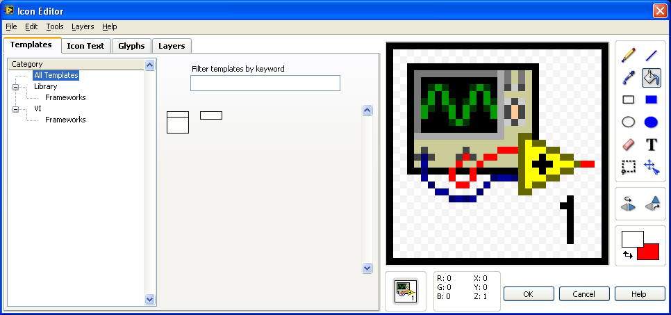

I really don't like the new icon editor introduced in LabVIEW 2009:
That was nice attempt to make "embedded Photoshop" with lot of features:
But I really don't like it, because:
- it opened EVERY TIME on the RIGHT monitor (I have three monitors, and primary monitor in the middle)
- it takes lot of time for launch (old icon editor was started momentally)
- from usability point of view - it was wrong to place tools on the right side. Commonly they located on the left side (and only in old icon editor, but also in imageprocessing software like Adobe Photoshop). Also front panel UI design... hmmm... this can be better...
- some bugs or changed functionality (for example - select ROI, then press <Del> button - nothing happened)
etc...

Go into <LabVIEW>\Resource\Plugins and rename lv_icon.vi. This is the plugin that's called when you invoke the icon editor, and if it's not there, LV reverts to the built-in editor (at least today. I'm not sure how many versions ahead they will keep the code).
You should note that the editor is open source, so you can go in and change what you want (or save yourself time and use the changes others have made, such as PJM's thread here. You may also want to look at the other discussions in that group).
