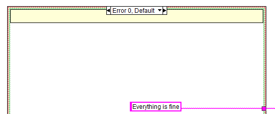

I installed LabVIEW2019 recently and stumbled now over a subject wich could cause alot of work with existing code, converted from older LabVIEW versions.
My existing code with wired error cluster to the selector terminal (which has only the cases "No Error" and "Error") now was converted to "Error 0, Default" and "Error 1", where an error now almost always (except errors with code 1) calls case the case "Error 0, Default", which was intended befor to be the "No Error"- case!
There still is the case "No Error" available in LV2019, but now I have to edit every single case structure in all my projects to work properly in LV2019.

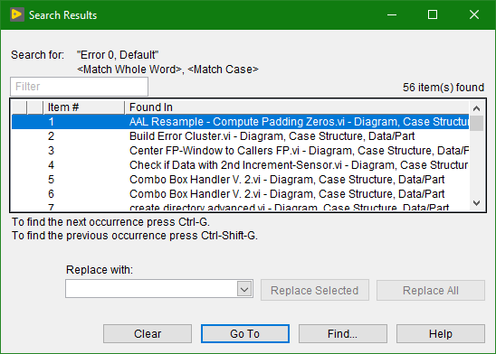

I made a quick search and found for my current project 56 case structures to change...

OK, a closer look to the search window brought me to a quick workaround, I replaced all occurrences of "Error 0, Default" with "No Error" and afterwards all occurrences of "Error 1" with "Default".
The replacement worked only with selected items ("Replace Selected") and even not for all of them, so I had to edit them manually. But now it's done. But I have a bad feeling about some not found cases or not some correctly altered case labels.

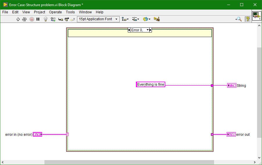

Hi Darren,
I made a new VI with LV2018 and attached it.
Opened with my installation of LV2019 the block diagram looks like this:

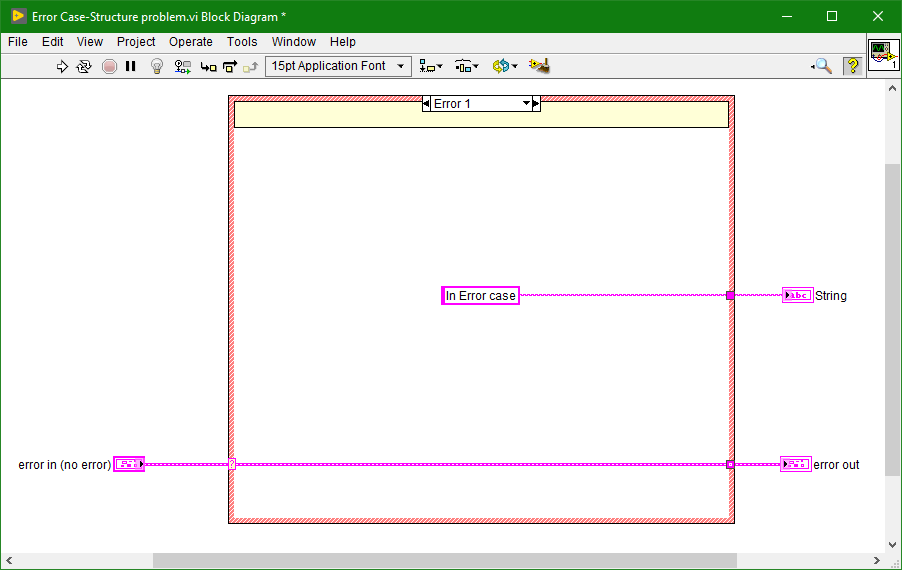

The other case:
As you can see, the selector label field changes its size when switching to "Error 1", switching back to to the first case now shows the full selector label text. I would consider this a cosmetic problem.

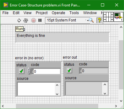

When this VI is run, it shows the following results:
Erro Case-Structure problem - Run - No Error.png          Erro Case-Structure problem - Run - Error 0.png
Erro Case-Structure problem - Run - Error 1.png          Erro Case-Structure problem - Run - Error 2.png

What bothers me is that you don't have an error cluster here, at least from the looks of the block diagram. The block diagram shows the error cluster as "any" cluster as LV did in the old days....
Norbert
Expert: Geometry
Message 6 of 14
(7,577 Views)
Yes, your right. This is intended, I didn't like this "new" mustard-look and deactivated it via the INI- Setting
funkyerrclustWire=False
Got it from here.
There you can see, how long this setting made no problems.
Greets, Dave
