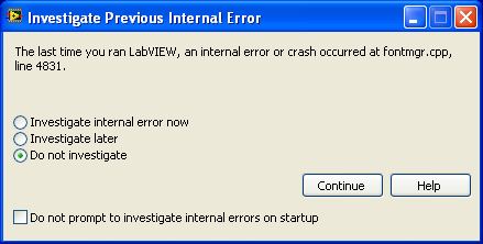

Fully understand that public forum is not "bug report tool", but anyway look how version 2010 works (crashes collected for last month):
During building of Project:
(very informative)
During editing: Ctrl+Z was pressed multiple times:
During Editing (CtrlZ multiple=
During closing project with XControl:
During Closing project with XControl Cut2.png(well, it seems to be trouble in MSVC run time)
During renaming library in project:
(happened multiple times)
During Mass Compile:
(its not crash, but very informative - which object caused this???)
During deleting broken wires:
Most of this crashes happened sporadically, so, I can't send bug report. Two weeks ago upgraded with latest 10f2, but situation is not better. Just today was crashed two times.
Andrey.
