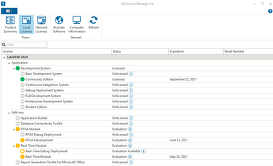

I see them in Licence Manager 4.6, but I cannot activate because I havent serial number for Evaluation.
In Licence manager I see Evaluation and Evaluation Available statuses. What I should do ?
Now you can do your evaluation of those products!
When the evaluation is successful you can buy the modules to receive your license number from NI…

AFAIK the CommunityEdition is not intended for use with RT/FPGA module. It supports LINX by default!
You may call your local NI sales and ask about RT/FPGA pricing/license options. In this call you can also ask about using those modules with the CommunityEdition: atleast this way you can get in (direct) contact with NI. (Without an active SSP it can be hard to start a discussion with a real person from NI…)
Btw. you can also install the "regular" version of LabVIEW and use the complete toolchain (LabVIEW+RT+FGPA) in evaluation mode to test your PXI setup!
