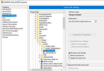

All of my *.lvclass files are in the "Always included" section and their destination is set to the executable (My_Wonderful_Application.exe)

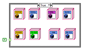

3) I have put constants of all my classes in my code like this
6) I have "played around" with the options in the application builder
For #3, there is something in LabVIEW where it optimizes your code to not include things that will never run.  As such, anything in the True case of a False constant may never make it into a build.
Try just removing the case statement... class constants are harmless to have on a block diagram if not connected.  When I do it I wire up the class constants to the edge of a nearby structure just so they don't show up as "unused code" in VI analyzer checks, but even that isn't necessary.  Just get rid of the case statement.

Finally, how does your code get this path:
C:\My_Folder\My_Application_Folder\My_Wonderful_Application.exe\Lib\Motor\Classes\ELMO\ELMO.lvclass
I would have expected it to just be:
C:\My_Folder\My_Application_Folder\My_Wonderful_Application.exe\ELMO.lvclass
Normally you don't see paths inside an EXE, so whatever you're using to load it may be adding paths that don't exist.

@Kyle97330 wrote:
I did this because of another comment from this thread, which talks about the same problem.
https://forums.ni.com/t5/LabVIEW/Executable-can-t-load-class/m-p/4210817/highlight/true#M1220214
I have also tried to put the constants without the case structure and in different places in my code all with the same result.
The relative paths stay the same inside the *.exe according to this.
https://labviewwiki.org/wiki/Executable_Directory_Structure
I have not changed the structure of my project, nor the code that loads my classes, so it should not have changed when i switched to LabView 2023 Q3.

@Kyle97330 wrote: Finally, how does your code get this path:
I'd only expect such a path if you have the Flatten file structure option. Otherwise LV .exe's havs an internal file structure, it's basically a ZIP file. In old versions it was a renamed LLB.
