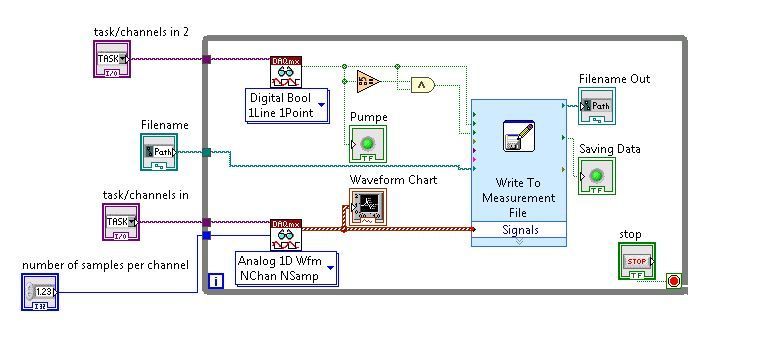

do you mind to attach your VI creating those "timestamps"?
How is that "250183,106000" number created?

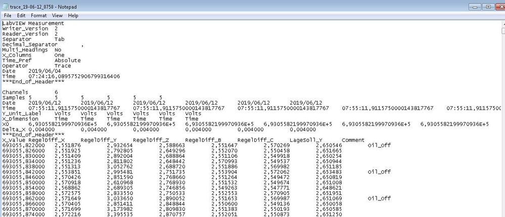

I have attached the .vi and the resultung .lvm.
I want to recalcalculate the "real time" from this X_Time_value.
Unfortunately, I do not understand how this number is calculated. I have already tried to interpret the number as Unix timestamp and calculate back. Unfortunately, that does not work. I already have a lot of data and would like to lose it now. That means a change to the .vi would be only my last solution.
Thanks!
(4,225 Views)
Hi Johannes,
you started your measurement on 2019-06-04 07:24:16 as written in the header.
The measurement data are from 2019-06-12 07:55:11 as written in the data section. The difference between both timestamps is about 8 days and 30mins.
That X values is the time in seconds since start of measurement: 693055s = 8d30m55s. Fits nicely to those timestamps given in your data file!

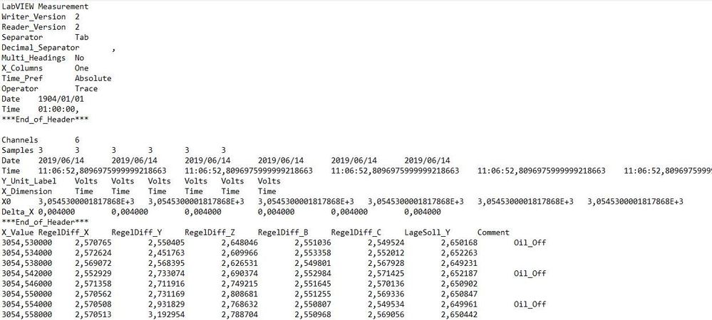

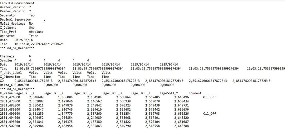

About the half of the files look like this:
Two files before... everythings seem to be okay.
Do you know whats Happening here?
Did LabVIEW lost some time reference here?
thanks!!
(4,210 Views)
Hi Johannes,
You did something with your computer or with your VI…
Apparently yes.
You still have timestamps in the data section and so you can calculate the correct timestamp for the header…

It would really help to see the code that outputs the Timestamp in such a strange format.  Have you looked at the functions in the Time Palette?  Have you tried the basic "Get Date/Time in Seconds" and wiring a default indicator to its output?  If you look at the Indicator on the Front Panel, you'll see it shows Date and Time, and when you run it, you get the current Date and Time ...
