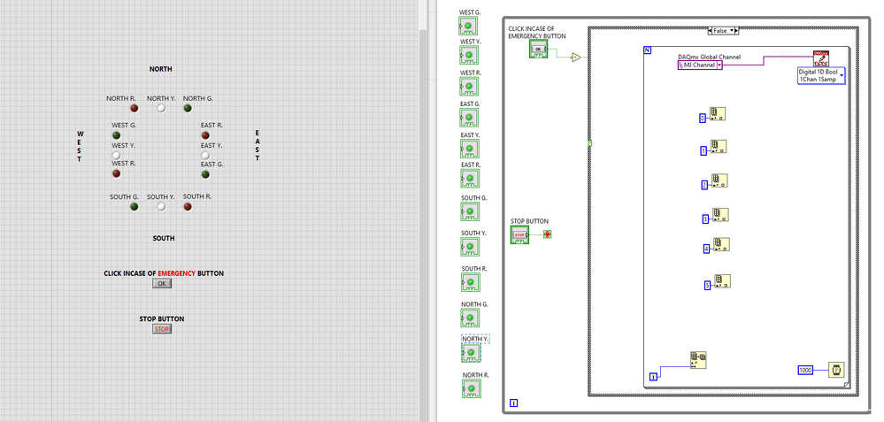

Sorry, but I've actually been trying. My friend did his with local varibles but that way is too difficult so I have decided to try another way. It's fine if you dont trust me or complete the question. I just need a little morte help than others. Capture.PNG

A few tips:
  • Search the forum for traffic lights. I am sure there are plenty of examples, especially in the certification forum.
  • As a first step, do a few simple LabVIEW tutorials.
  • As a second step, program it as a simple simulation to work out the logic. No external hardware, just the LEDs on the front panel. Once this is fully functional, adding the hardware is trivial!
  • "Index array" is resizable. You only need once instance. Why are the even there? You don't have any arrays!
  • Why do you need the FOR loop if you are already spinning the while loop at regular intervals?
  • Define a reasonable loop rate for the while loop.
  • All your indicator belong inside the while loop after the case structure.
  • There is no need to NOT the boolean, you can just swap the cases.
  • Your channel constant belongs outside the toplevel loop. It never changes.
  • A state machine has been suggested. think about how many states you have and create an typedef'd enum, keep the state in a shift register and wire it to the case structure. Create a case for each state.
  • If you want help, it is better to attach VIs instead of pictures. What's in the other case?
