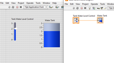

For a class project we have been asked to create a water tank which has input and output triggered by 3 sensors  as the water level decreases below each sensor an event is triggered represented by an LED the tank goes up in increments from 0 to 4  . when a sensor is submerged in water it has an output of 1 when it is above water it has an output of 0. I am able to adjust the water level up and down with the slide controller however I am not allowed to use the analogue value for the water level in the control system design so I am now stuck and seeking tutorials on this or I'm not sure I'm going about it the right way.
So I have the tank level controlled by the analogue slider set to full this will result in all sensors having an output of 1,1,1 if correct i need something that will process various results and trigger necessary event/LED.

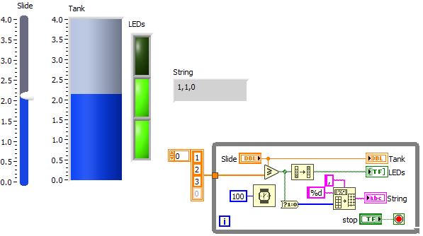

Start with something like the following. You can convert the Boolean array or an integer array of 0 or 1 to be sent to your control systems, whatever format that expects.
You really haven't explained the details of the hardware and such.
