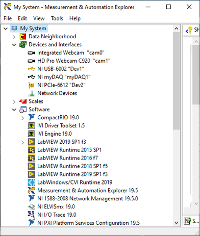

Yes, I can confirm that you need the NI Elvismx Driver.  Here is a screen-shot from MAX with a myDAQ plugged in (when I plugged it in, I got the "USB Sound", then a screen popped up saying NI myDAQ detected (see below).

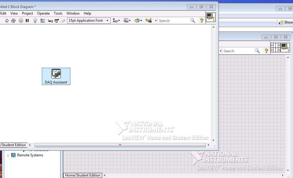

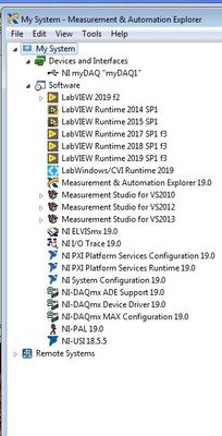

This is what I am getting under Measurement & Automation Explorer. I attached a picture of the problem as well. I add the DAQ Assistant and it is freezing up. Could it be the computer? I am 30 minutes away from going and buying a new computer.

It looks like you have the software that you need installed.  I'm happy to try to duplicate what you are trying to do, but I'm not sure what you mean by "I add the DAQ Assistant".  [This is not the time for me to start my rant about the Dreaded DAQ Assistant, and recommend that you find and read "Learn 10 Functions in NI-DAQmx and Handle 80 Percent of your Data Acquisition Applications" ...].
So I have a laptop with Windows 10, LabVIEW 2019, and a myDAQ.  What is it that you are trying to do with such a system?  Are you developing new code?  Are you just "trying it out" to see what happens?  If code is involved, please attach it so that I can try to "do what you are doing".  Otherwise, give me a set of steps to try and see if I can figure out what is going on at your end.  It is possible (but perhaps with low probability) that the myDAQ and LabVIEW are no longer compatible, but before you go buy another computer, let's give it one more attempt ...

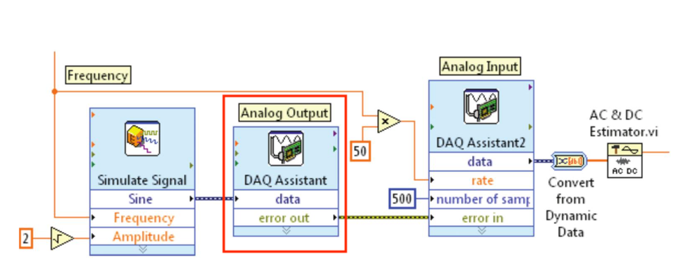

Here is the assignment that I am working on. The process is to add each of these components/functions into the block diagram and then use the myDAQ to obtain a Bode plot on an RC circuit. I started by adding the "Simulate Signal" and had that configured correctly, but when I get to the "DAQ Assistant" part (outlined in red), LabView freezes up.
If you're able to insert the function outlined in red without LabView freezing, you are getting farther than I am.

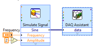

I am able to "insert the function outlined in red without LabVIEW freezing."  (Note the correct spelling of LabVIEW -- it is an acronym).  Of course, I don't quite know what you mean by "LabVIEW freezing".  When I dropped the Dreaded DAQ Assistant onto my Block Diagram, it opened, I chose "Generate Signals" (since you want to use Analog Out), chose "Analog Out", and got the message "No supported devices found".
So far, so good.  The Message was correct -- not only was no myDAQ plugged in at the time, I don't believe its Driver had been installed.  So I opened MAX, opened Devices and Interfaces, and added a Simulated myDAQ.  Here's what I got:
It is not clear to me what you are doing wrong, since it is difficult to watch you do it.  Why don't you talk to one of your classmates and get her (or him) to help you ...
Bob Schor
