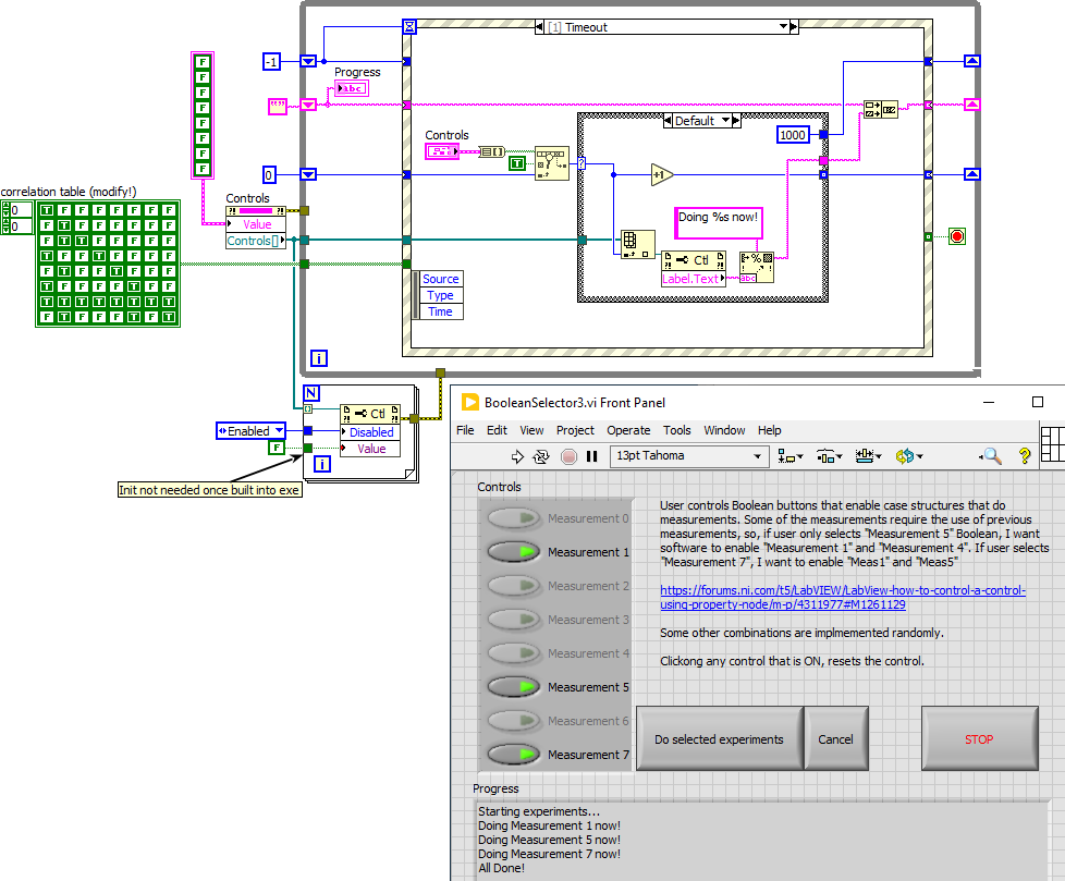

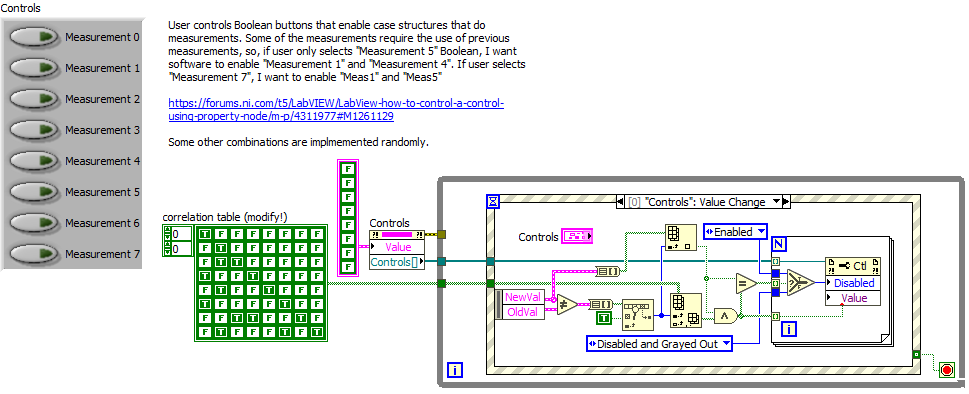

Maybe all you need is a single cluster of booleans. Here's a quick draft. Later you can iterate over the enabled/TRUE controls to do the experiments in sequences (not shown).

Here's how it could do all scheduled experiments in "OLL" using the timeout event.

@John32d wrote:
Some have suggested using Value property node but it basically hardcodes the value, so if Measurement 5 is not enabled, I cannot enable Measurement 1.
In your original post, you have 100% correlation between value=true and state=enabled. You can easily modify my code to do something else, e.g. enable certain other switches based on the first selected switch. In that case you probably need a secondary "reset" button to set things to default. You have not defined the entire dependency table and how they are correlated. For example, if you turn on #7, which would enable 2&3 and then you turn on 2, would that enable other buttons if needed?
