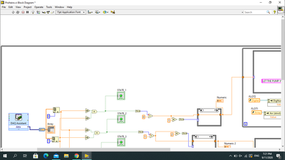

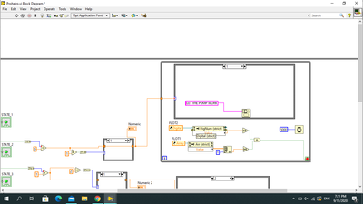

iv made up three states that the sensors can be . when 1st state appears the programma enters in the case condition as shown in the second picture which has a while loop and i want to stop the condition-while loop as shown but the values are not updated when running it. You can replace the sensors with numeric controls

@Sam_Rudneff wrote:
Hi!
It would be much easier to figure out the problem, if you attach a vi or a block diagram screenshot.
A screenshot is practically useless. Attaching an actual vi is much preferred.
Message 4 of 13
(4,913 Views)
Please attach your VI. truncated pictures are useless for us.
  • You have multiple while loops, so which one are you talking about?
  • What's in the other cases of the case structure?
  • Index array is re-sizable.
  • +0 does not do anything useful.
  • You can wire a boolean to a case structure directly. no need to convert it to 0,1.
  • All numerics derived from booleans should be Integers (blue, not orange). Do you know the difference?
  • You definitely don't need any value properties nodes.
  • You can probably simplify the code by using more arrays.
Message 5 of 13
(4,904 Views)
Rarely is there a need for a while loop inside a while loop. You need to restructure this into a proper state machine.
Some other glaring issues in the screenshot that you shared:
1. You are mixing orange and blue lines. If you add a number to an integer then use an integer. Also, there is a +1 primitive that you can use.
2. Never test equality of floats.
3. I see local variables, meaning that there could be race conditions associated with your program. Use wires instead.
4. Your inner while loop is blocking - learn about THINK DATAFLOW. This will lead you toward a state machine design.
There are probably other things - these were just a few glaring issues.

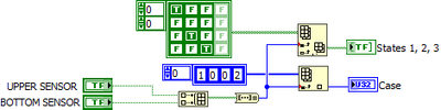

@johntrich1971 wrote:
Also, why do you convert the boolean to a number and then use >0 to convert it right back to a boolean? That's pure Rube-Goldberg. Use the boolean directly. You can use a NOT to get the same result as your <=0.
Even simpler. 4 booleans can have exactly four conditions, so just do lookup tables, e.g. as follows. No need to overthink this ;):
