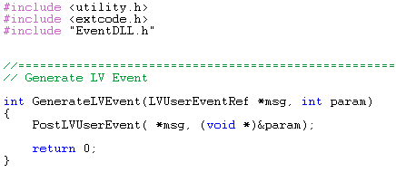

If the dll is used from within LabVIEW, you can call PostUserEvent . It
takes a reference to the registered event (as I32) and the data. The data
has to be in the right form, or crashes are likelly to happen...
Wiebe.

I'll suggest to use PostLVUserEvent function. Its pretty easy:
In your DLL you should call it by the following way:
and then use it in LabVIEW like this:
you can put PostLVUserEvent into your callback function called in DLL and get callback messages in LabVIEW.
See also (exactly the same example): Posting Events to a LabVIEW Event Structure From a Dll

"Wiebe@CARYA" <wiNOebe.walsSPtra@carAMya.nl> wrote in message
news:4858e51e@PYROS.natinst.com...
> Regards,
> Wiebe.
Yes, PostLVUserEvent... Like Andrey said.

@waszil wrote:
It is fantastic! I did not expect such great help!
Anyway, I do have some more questions, but I think im getting to understand this whole thing.
So, how do i create this labview.dll? Where can I find the utility.h and extcode.h? I guess they implement the connectivity between labview and external codes.
And do I need some extra stuffs for building this dll?
thanks
Cs.Nemes
You'll write in C a DLL (Visual Studio is recommended here strongly) and you find the extcode.h and other necessary files in your cintools directory inside your LabVIEW directory (if you have LabVIEW Full development System or better, it's not part of the Base package).
Also in there is a labview.lib file which you need to link with your DLL project and that will take care of importing the LabVIEW manager functions you are ging to use.
