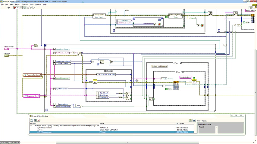

Hi Rolf,
Hereby a screenshot of the labview code, i placed probes to show the 2 user event refs are different.
Also put the DLL debug output when the LVUserEventRef pointers are passed through the call library node.
The concerning Vi and DLL API header file are attached in the zip file.

They better be different on the LabVIEW diagram! One is a notification refnum and the other is a user event refnum. Two totally different things! The user event refnum wraps the notification refnum which is in itself a somewhat roundabout way to do this as you could just as easily only use the user event in the first place.
There are some problems with your approach:
PostLVUserEvent() expects as its second parameter a pointer to the datatype that your user event wraps. Usually that is a numeric, an array or string handle or a cluster of those things. But LabVIEW allows you to wrap other data in an user event. However there is no documented way to create a notification refnum or any other of those refnums in the C code. So in order to pass the right data to PostLVUserEvent() you would also have to pass the notification refnum itself to the Call Library Node, store it somewhere and then pass that to the PostLVUserEvent(). There is a very strict match required between what the user event refnum wraps through its Create User Event node and what you pass as pointer to PostLVUserEvent(). You got lucky here, since refnums have a build in verification mechanisme that simply generates a Not A Refnum result, if the refnum is not a valid refnum in the currently registered refnums for that type. With other data you can easily get a hard crash if those two don't match since LabVIEW has no possibility to verify that the pointer you pass to PostLVUserEvent() is indeed the data that it implicitedly expects due to the datatype that the user event refnum wraps.
However wrapping a notification with a user event refnum is most likely anyhow the wrong approach. Better would be to wrap the actual data that you can directly use in the event structure such as the index into the boolean control refnum array that you want to set to true. Pass that index to the Call Library Node function and then let PostLVUserEvent() send it to the event structure. That allows you to create one user event for an integer and also saves you from having to register a new user event for every transaction as well as doing a roundabout way of identifying in the user event structure which event was triggered. Don't use the user event refnum itself as identification but the data that the user event carries along!
Personally I could think of even better ways than directly access the boolean control through a refnum from inside this driver VI, but that would go to far to try to teach you here proper application design too.
