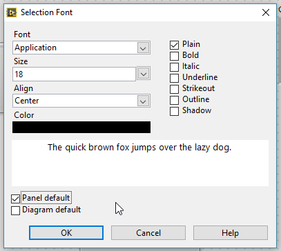

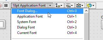

Ok, just found the solution myself. You have to access the font dialog. There are checkboxes to achieve what I needed:
Thanks anyway!
