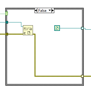

Using LV scripting, I created a case structure and populated the "FALSE" case, tunnels were automatically created when contents were wired:

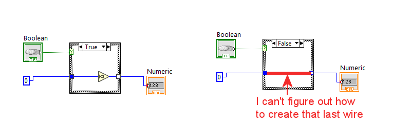

I would like  the "TRUE" case  to act as a pass through. Which is trivial if done manually:

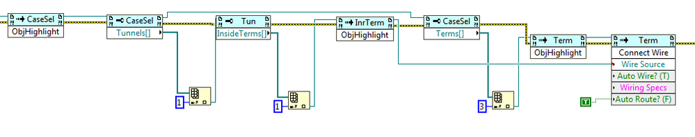

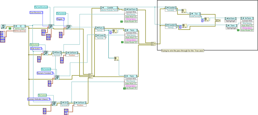

But looks like it's quite tricky to do it through scripting, here is the best I managed to do:wiring-tunnel-problem4..png

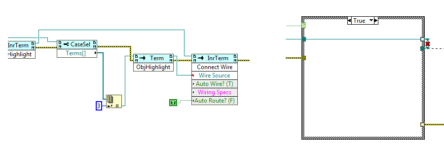

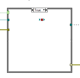

I used ObjHighLight to make sure I was working with  the right terminals.  Although I'm trying to wire the tunnel's inside terminals,the result is somewhat disappointing:

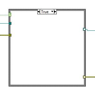

When using clean up, one notices that the wiring was done outside the Case structure, hence the connection error:
Oddly enough, switching the two terminal parameters in  the Connect Wire node yields a different result:
What am I missing ?

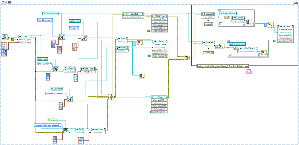

Well, I am experiencing the problem in a quite large project with a lot of dependencies, but  here is a simpler example exposing the issue (VI attached):
And here is the result:

Those tunnels have inner and outer terminals. 1 outer terminal per tunnel, one inner terminal per case for the inner tunnel.
You can get those inner tunnel terminals from the case terminals (*sigh*), but there are 3 case terminals, so you'd need a way to select the right ones...
(3,099 Views)
Thank you  wiebe@CARYA Smiley Happy, I figured that it was a matter of getting access to the inner terminals,  but I never imagined that I had to cast the case structure terminals into outer terminals in order to get access to the inner part. Tricky.
