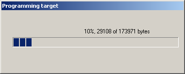

Example of DLL windows when updating the firwmare of the device which is slow:

When I strike the keyboard or move the mouse, the window (see example) is normally updated each time I strike or move.

About the speed, depending of the function called form the dll, the function can be simply stopped (I have to move the mouse or strike the keyboard to go further) or it is during more than 2 times of the normal time.
