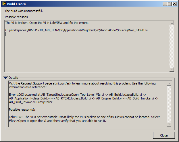

My Latest Bug:
Am I Wrong to expect the following.
Code that deploys from the development environment should
a: Build to an .RTEXE
b: Run on the target.
I can Deploy and Run my code but
I get the following message when building
I can make it disappear by Diagram Disableing out some specific, Unbroken VI's
I know I write some rubbish code from time to time, usualy manifesting itself as a broken arrow or unexpected functionality, When there is no Broken Arrow, or successful deployment,  I don't stand a chance.

Maybe you're seeing the same problem many of us are seeing when compiling:
Try this: http://digital.ni.com/public.nsf/allkb/3CC2144F391E7C9C8625764D00722173
and this: http://digital.ni.com/public.nsf/allkb/705C2ECA081F3C7986256C0F00559B02
I also have to uncheck the box "Modify Project Library file after removing unused members".
Looks like you're having a hell of time with 2011. Smiley Frustrated Smiley Wink
I spent about a week debugging when I "upgraded" to 2011 SP1 too.
