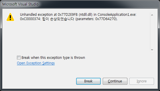

LVTest.lvproj in the Labview Test Project folder After building the DLL file using the Labview project, when the Initialize function is called from the ConsoleApplication1.vcxproj C ++ project that is attached, the break will be caught inside the function (image 01)
It will exit from the hash function. However, if the heap corruption message (image 02) appears, and you continue to execute again, you will exit the function.

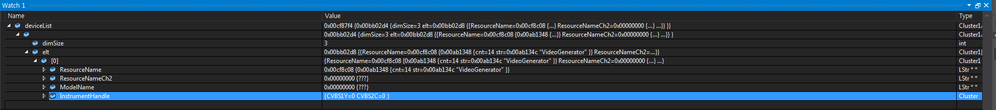

If you check the value of the deviceList variable passed as an argument, you can check that the value has been entered normally. (03 image)
