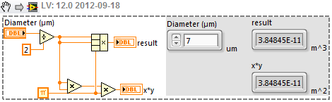

Just came across the same bug - my example is computing the area of a circle:
In related news, the Square function still doesn't handle units properly some 5 years after being reported.  It even has a 5-digit CAR by the looks - how many of those are still unresolved?
