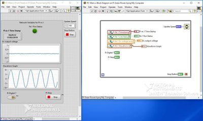

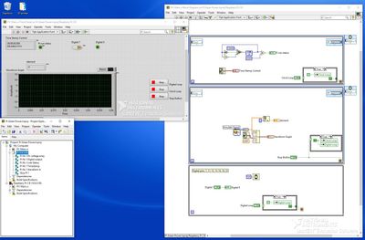

Hello I am trying to use the LINX on an Pi 2B to read data and to controll LEDs.
I am able to read data from the Pi, but I am not able to send commands to the Pi.
When I press the button on PC main the button on Pi Main lights up, but the LED Connected to the button on Pi Main does not start.
When pressing button on Pi Main the LED also lights up.
Way does it not work using global variable when I use my main computer as an global variable server.
Look at the video link.
