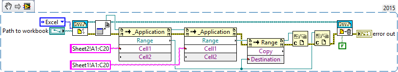

There is no need to import the range value to LabVIEW and then to write it back to Excel if you use the Range.Copy method. Here's how to use this method (I used the RGT vis to open Excel and to get the Excel.Application ActiveX reference, it was faster to validate the code of interest)
Ben64
