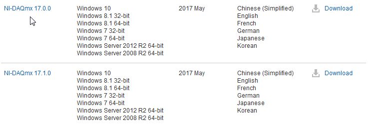

Don't mean to hijack here, but I will probably update soon to 2017. What is the difference between DAQ 17.0 and 17.1? See screenshot below.

17.1.0 is a fast-follow patch fixing an (OOPS) in the 17.0 build.  The Update service will catch the need for the patch and explain it in more detail if you want to know more.
Message 8 of 11
(12,233 Views)
Thanks. I was curious as to why they list 17.0 first.
Cheers,
mcduff
Message 9 of 11
(12,230 Views)
Well, let's go look at the Readme.html...
For 17.1.0:
New Features
  • Added support the NI cDAQ-9185 and NI cDAQ-9189 CompactDAQ chassis.
  • Added support for the NI 9207 Spring Terminal, NI 9208 Spring Terminal, NI 9209 Spring Terminal, NI 9224, NI 9228, NI 9250, NI 9425 Spring Terminal, NI 9476 Spring Terminal, and NI 9775 C Series devices.
  • Added support for the PXIe-4309 and PXIe-4310 SC Express modules
  • Added support for the NI CAL-4309, NI TB-4309, and NI TB-4310 SC Express accessories
In other words, it looks like whoever updated the drivers forgot to add the support for some new instruments and/or accidentally deleted them (I do not immediately recognize any of those numbers, so I can only guess as to which way it went).
