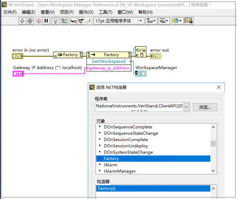

I want to do as my topic shows. to use LabVIEW 2018 to call Veristand2015.
NI says that we should keep them the same verison,  but I had opened the veristand package in LabVIEW2015,and found that LabVIEW is using .NET DLL to call Veristand2015.
CAN I mannually pack that VS2015 .NET dll by LV2018 ? I think it is possible .
Will there be any problem if I do like that ?

VeriStand 2015 is not compatible with LabVIEW 2018, so if you do that most probably you will face problems.
As mentioned in VeriStand Modeling Version Compatibility
