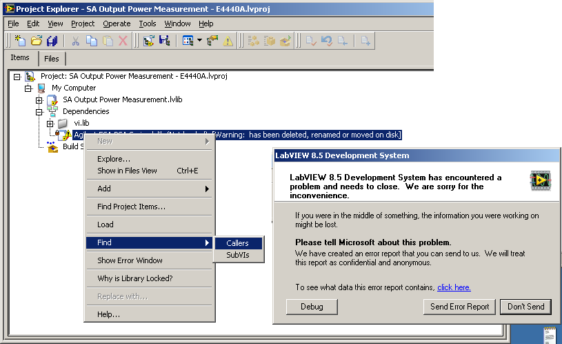

SYNOPSIS: When selecting Find > Callers, under the project Dependencies, LV crashes as shown in the image below.

Here's the picture:

10. In the dependencies tree, I right-clicked the error message and selected "Find>Callers", as shown in the attached image of the original post. Got the crash message.  I repeated this 4 times.  Rebooted the PC, and repeated it twice. All the same result >>  Crash.   I may have saved a copy of the "crash" report, although I doubt it...  I didn't bother sending the report to MS; because, well, I don't have much credibility over what those guys do at MS.
