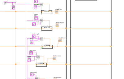

Hi. I am brand new to labview. What I am doing is pretty much sending around 80 serial commands at once (according to the set interval). Returning the read data as an array thats been split by new line. Then parsing for the voltage values and displaying that voltage on indicators (eventually to a chart/graph). It seems like my block diagram is becoming very very cluttered. Is there any design techniques or philosophies or tips that I can use to shorten and compact this.
As you can see I am just going down and down the page. To my knowledge I think this is very bad programming practice LabView and would like to fix it. If you have any insight that would be greatly appreciated - Thanks!

Yes.  Seeing only a partial screenshot of your code means we can't see everywhere the data is being used or possibly changed.
You might also want to consider using a feedback node.  For instance, if a value is being changed or used only within an embedded loop or a specific case, you can place a feedback node in there and it will keep the wiring within that structure.  You won't need to run wires through other case structures or loops that aren't using that data.

Hi Tim
Unfortunately I don't think I can post the entire block diagram but the picture in the question is the main thing causing what I think is poor practice.

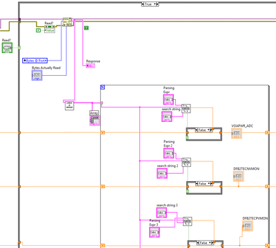

Basically here is the structure:
->Write Serial Commands
->Read All Serial Input -> Split the response string by lines -> Iterate through each line look for certain words -> if that word is found get the voltage from that line
->Flush buffer
Here is a better pic:
The parsing and then displaying to an indicator keeps on repeating all the way down. That is what makes it so cluttered.
(2,902 Views)
I think I would use a cluster. Inside of the cluster I would have three controls:
Parse Expression
Search String
Double Result
Place the cluster into an array. Now you can index through the array and find the value and add it to the Double Result.

  • All you probably need is exactly one shift register containing a 1D DBL array where you replace elements depending on the position and boolean.
  • Autoindex on arrays of "search strings" and "parsing expressions" to avoid all that clutter. Terminals belong before the loop unless you expect them to change during inner loop execution (unlikely and dangerous!).
  • If the shift register is only accessed in the inner loop, use a feedback node instead.
As others have said, we cannot help more unless you actually attach a simplified version of your VI.
