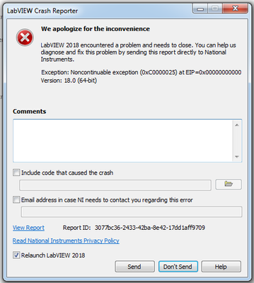

I call the python keras based Neural network model in LabVIEW 2018 using python node but  the LabVIEW crash when i include the keras function in it otherwise the other python codes working fine in it.

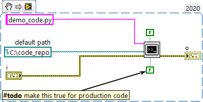

Can you try calling the python code directly not from a python node? You can try this ( put in your code path and name):
This will use whatever python is loaded to your system PATH variable for python so you can use whatever version of python you want. You can also pass in variables as args and kwargs.

thanks jay for your help.
this is work for me
