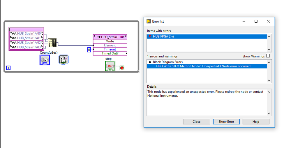

I am facing a weird issue with my LabVIEW FPGA code.
I have a NI 9237 attached to cRIO 9035 and I have created a FIFO of 32767 elements and data type is fixed point. I combine all the 4 channel data and wire it to the fifo and everthing seems fine. But as soon as I save the vi it gives a broken arrow and the error redirects to the FIFO stating : "This node has experienced an unexpected error. Please redrop the node or contact National Instruments.

You might try pipelining the data through the loop, so you wire the data array into a shift register, and then feed the shift register into the FIFO.
I assume it's a target to host DMA FIFO? Does a smaller FIFO size have any effect on the error?

Thank you for replying,
I have tried pipeling but that doesn't seem to work.
Yes it is a Target to Host DMA and the fifo size does not make any difference and the error still persists.

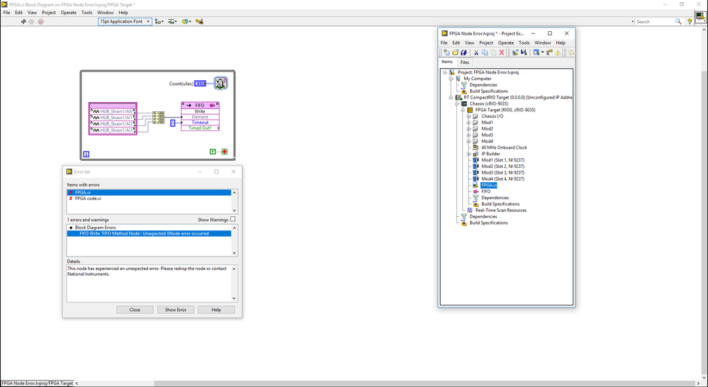

I made a quick project with your hardware configuration and FIFO, and didn't seem to have any issues saving. I've attached the code - see if you can open and save the FPGA VI.

Thank you MichaelBalzer for the code.
I beleive the problem is with my Labview because when I opened your labview project I am facing the same issue. May be I need to reinstall LabVIEW.labview error.PNG

It does look like an installation issue. You might try reinstalling the FPGA module first, or bite the bullet and reinstall everything.
I'm using LV 2017 at the moment.
