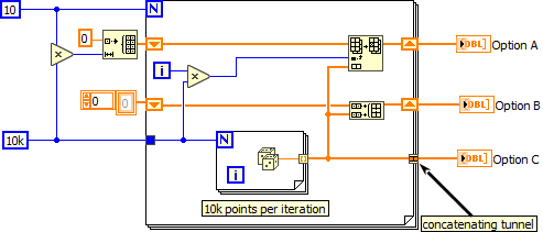

Here are a few options. All three give the same result. It also depends if you need to display the array as it builds or if it is sufficient to get the final result.
A: Replace array subset
B: Built array in concatenate mode
C: Concatenating tunnel.
