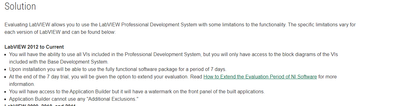

I want to test Hilscher CIFX 50-RE card with Labview . But I want to understand which Labview sotware edition to be procured ?
Below are the links I am refering for CIFX integration .
https://knowledge.ni.com/KnowledgeArticleDetails?id=kA03q000000YGZjCAO&l=en-IN
https://knowledge.ni.com/KnowledgeArticleDetails?id=kA03q000000YGggCAG&l=en-IN
So I want now the software on my system .Is there any free edition available for testing ?

Labview used to have an evaluation when you first download it.

Even the LabVIEW Base version is able to let you use either of these interfaces. And as long as you only are trying out things without creating any product or application with LabVIEW, you can also use the Community Edition.
