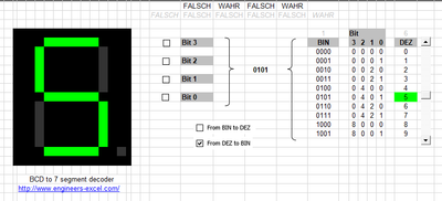

@Tommy12310 wrote:
 i just want to see the Front panel and Block diagram so i can compare. Please if you could try this problem and attach the Front panel and Block diagram
this is all about binary to decimal number system conversion
the frontpanel of a 7 segment bcd done in excel
you could turn this into -2 to 2 by using bit 3 as a sign bit
e.g.
1010 =  -2
1001 =  -1
0000 = 0
0001 = +1
0010 = +2

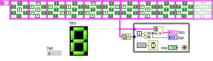

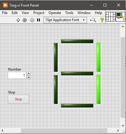

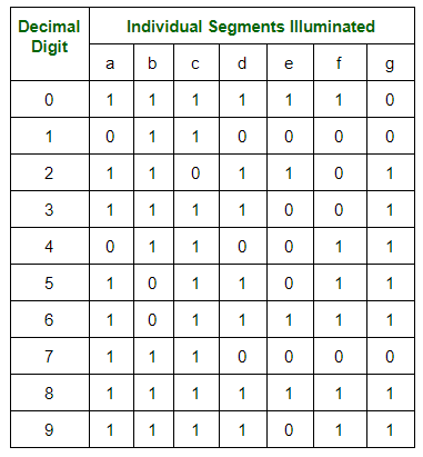

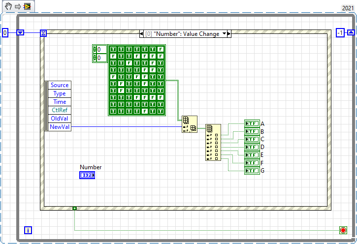

I am not going to do your homework for you, but here's how I would do a seven segment numeric display.
Start with one of these charts...
That looks like a Boolean array to me...That looks like a Boolean array to me...
=== Engineer Ambiguously ===
That was actually a problem for one of the "challenge the champions" events at NI week a few years ago. I was sitting in the front row and cringed at the solutions they were tediously constructing while I was imagining something similar to the following:
Note that the arrangement of the cluster constant element mimics the display, for very easy (and fast!!!) setting of the patterns.
(The solution for that challenge would just to have a control for the index, so this is a bit fancier, cycling through all the numbers. We could expand and create an array of clusters on the front panel and parse multidigit positive integers. Scalable!)
